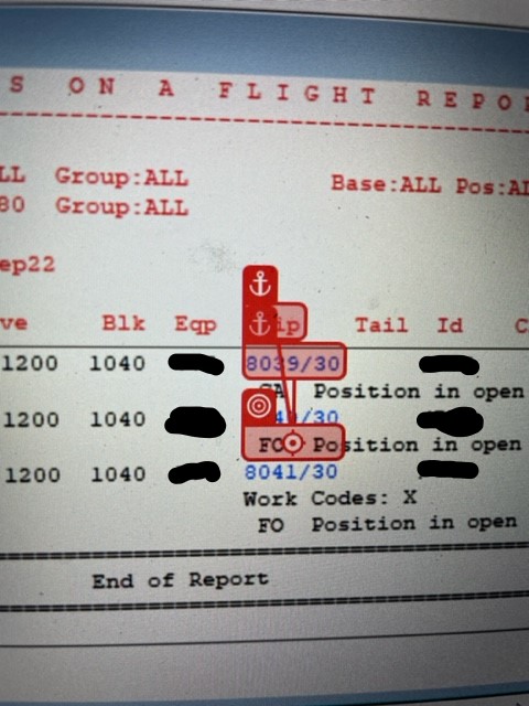

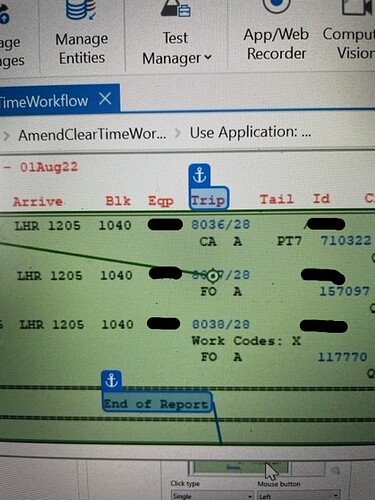

Let me show you how I targeted it so far, maybe it’ll give you ideas! This is a pic of how the target/anchors are set (I used Trip column head, as you suggested, as one of the anchors). BTW, to achieve selecting Trip and End Of Reports as anchors, I had to tick the Enable Native Text option (I can’t find another way to select things like Trip as an anchor otherwise):
As you can see, there are two lines between each trip. This is the case for trips that already have crew allocated .And the robot works fine for screens that have that 2 line spacing.
However… there are case where crews have not yet been allocated to a trip, in which case they use a default blank crew member, but this results as a single line spacing between trips:
As you can see from the position of the cursor, UIPath is trying to find a link one line below where the link for the trip is, because of the single vs double spacing issue.
Hope you can help! I’m lost :thinking:
Vincent
FYI I have tried to improve the targetting using different types of anchors (see next two pics), but they all fail when the spacing changes…
Starting to think there might not be a solution!
