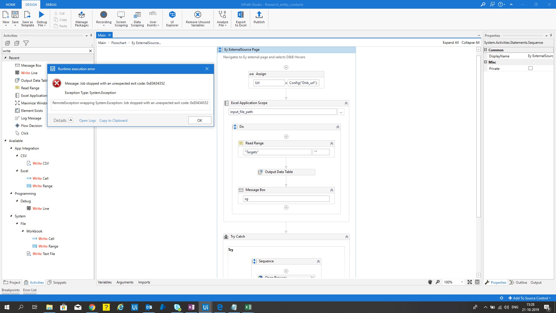

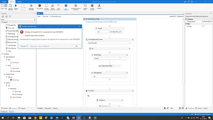

Job stopped with an unexpected exit code: 0xE0434352
Unable to create data table with particular excel file.(Issue faces with this excel file only). Read range is not working but read cell is working fine.

From the snapshot you shared it’s evident you are reading an MS Excel through an Excel Application Scope and further using Read Range to construct a Output Data Table. It’s not that super clear if you are trying to do in the following Try-Catch block and possibly you are trying to write back to the existing MS Excel.

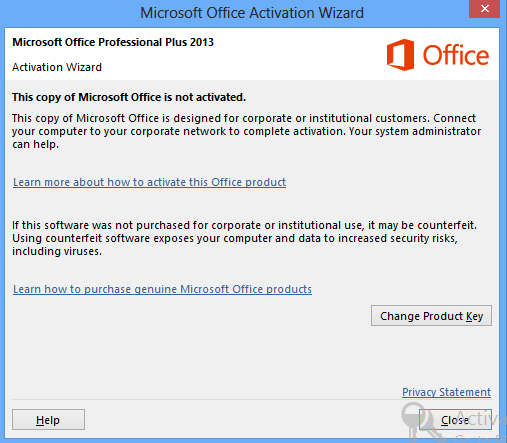

In these cases, if the Excel Application Scope property Visible is set to True then UiPath needs to have the MS Excel software installed within your system with a valid activation code. Else each time an MSExcel will be opened and the Microsoft Activation Wizard will get opened (stay at the front/back of all the opened applications) and cause error while MS Excel read/write operations are done by UiPath.
MSOAW
Another approach will be to work with MS Excel and Excel Application Scope with the property Visible is set to False

I am using enterprise version of microsoft which is licensed one. so there is no activation window pops up when i execute excel files. This issue is facing only with this particular excel file only. I cant figure out why this happens only with that file.
