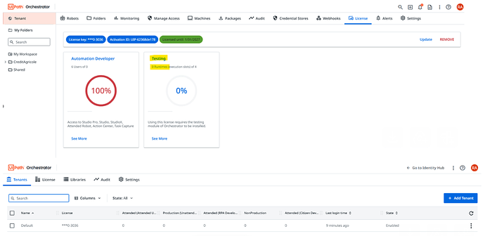

we are working with a client and facing an issue with the Unattended Test licenses in the Test (non-production) environment.
  • The 4 UiPath – Flex – Unattended Robot (Test) licenses are visible in Orchestrator.
  • However, no [Robot] Service is consuming them, so they remain unused. (see the screenshots)
  • From UiPath we were told these licenses can be used to run automations in non-production (without Test Manager), but configuration seems to be the blocker.

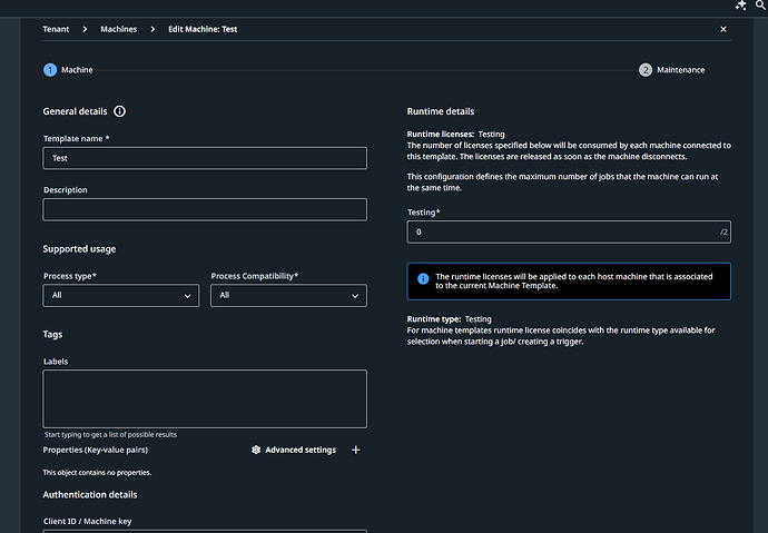

So you need to assign the licences to a machine template, I assume you have not done that?
Once you get Test Licences a new option will appear

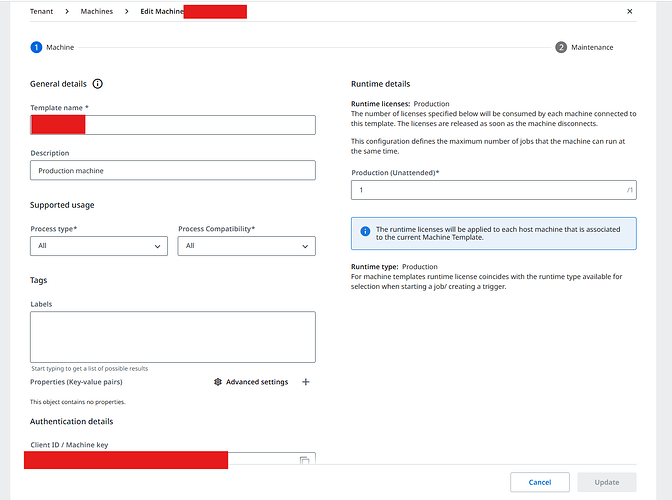

This is what it looks like if you have no Test licences,
But when you do it looks like this (Dark mode is just a theme difference between these orgs)
Once you do that, add the machine template to a folder and the robot account to a folder in the same way you do with a normal unattended robot, and then you can start test cases or test set uploaded to that folder.
Indeed you do NOT need Test Manager to consume these licences.
Hi John, thank you for the answer!
Our situation is that: we don’t see any field:
Can you help us in understading why?
regards

Taking a closer look at this, I notice you have got an On Premise install, thats quite likely the issue here. I am afraid I am not an expert on the On prem infrastructure when it comes to testing, there is a message in your screenshot saying a module needs to be installed?
Hi John! yes you’re right! We are on pre. 23.4 (it should be).
and this is the error message: “Using this license requires the testing module of Orchestrator to be installed”, you know what it is?
@Riccardo_Vecchi
As per error looks like you installed standalone orchestrator ..Test manager setup needs to be made
