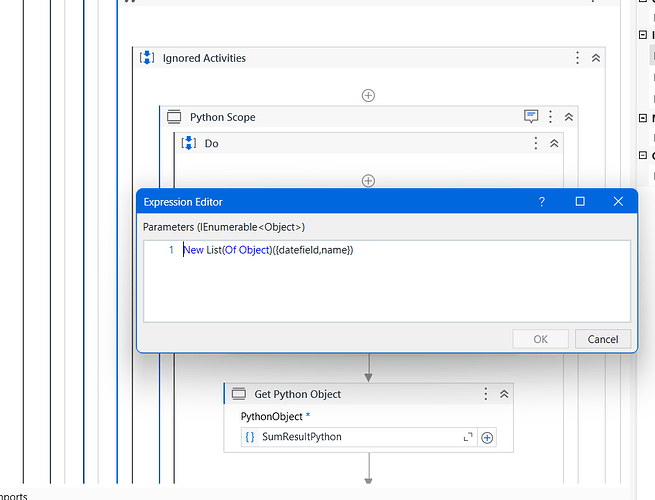

@divyanshu52
Can you also share the properties of Invoke Python Method activity
INVOKE Python Method - Parameters
INVOKE Python Method - Properties
@divyanshu52
Try passing the parameters as array of string, for example
{"datefield", "name"}
