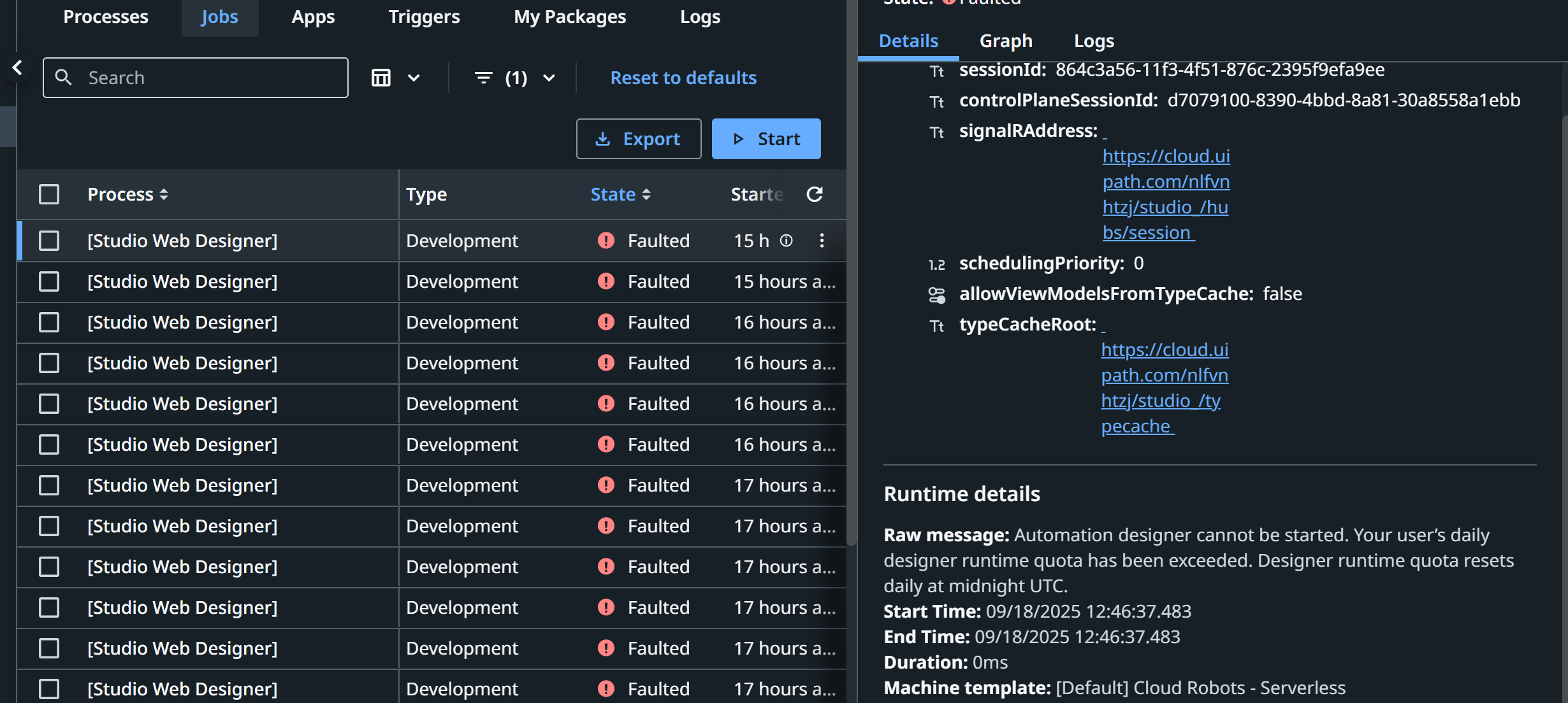

  1. Designer Runtime Quota Error
In jobs, for Studio Web, I’m seeing this message: (PFA screenshot)
“Automation designer cannot be started. Your user’s daily designer runtime quota has been exceeded. Designer runtime quota resets daily at midnight UTC.”
Has anyone else encountered this combination of issues? Any suggestions on how to fix the element detection error or if there’s a workaround for the daily runtime quota?

This Error is not about your workflow it’s about UiPath Automation Cloud licensing limits for Studio Web.
Cloud Robots have certain limits
why you are using Studio web try studio desktop instead
@NL_RPA
There is no workaround for daily quota limit..community license comes with its own limitations as it supposed to be used for learning purpose only
