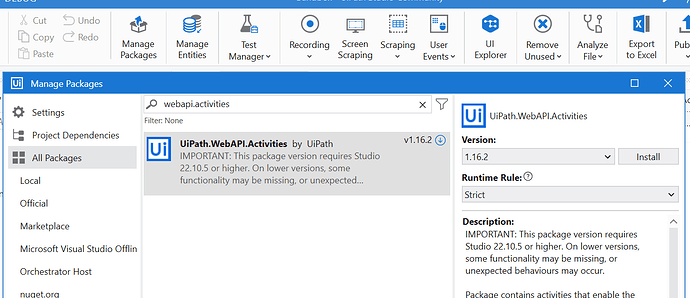

It would be helpful to have the documentation of the API you’re working with in front of you while developing. If you’re working with the Orchestrator API, you can type /swagger at the end of the Orchestrator URL in the address bar and you will get access to its documentation.
Make sure the add the UiPath.WebAPI.Activities package to use the HTTP Request activity:
