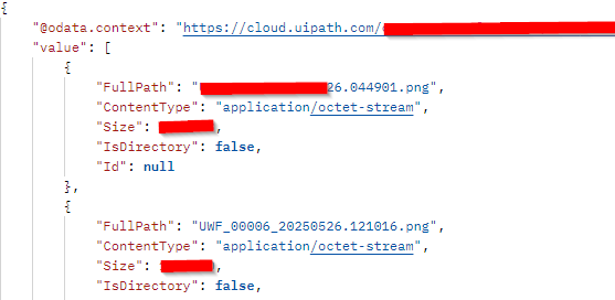

You can follow below approach:
- Get your bucket id using /odata/Buckets
- Use below url to get files in your bucket
/odata/Buckets({bucket id from step 1 goes here})/UiPath.Server.Configuration.OData.GetFiles?directory=%2F&recursive=false
this would give you response like below:
Now deserialize this json response to fetch all values of “FullPath”. this is the path for your files in storage buckets.
Now run loop for all the full path values fetched after step3.
for each path, hit the url like below:
/odata/Buckets({bucket id from step 1 goes here})/UiPath.Server.Configuration.OData.GetReadUri?path={full path fetched in last step goes here}
this step gives response as below:
“Uri” here is the direct download link of the file.
then you should be able to use download file from url activity to download the same.
