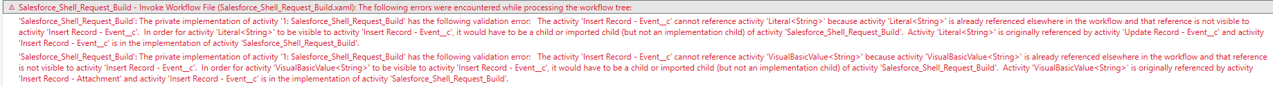

Invoking Workflow file immediately crashes with 2 error messages related to different types of strings (Literal<string> and VisualBasicValue<string>)
The invoked workflow file uses the UiPath.Salesforce.Activities package (1.9.3 currently but the same issue was returned in v1.8.0) to create a link using the ‘Insert Record’ as well as the ‘Update Record’ activity to upload attachments.
Any idea what the fatal error may be related to? I’ve checked and all values being passed and retrieved are basic string values. Please see the below screenshot for the exact error messages being returned.

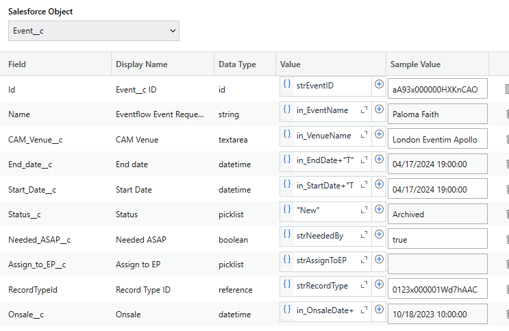

Error indicates the issue is with your ‘Insert Record’ activity, can you show us that?
Please see below.
