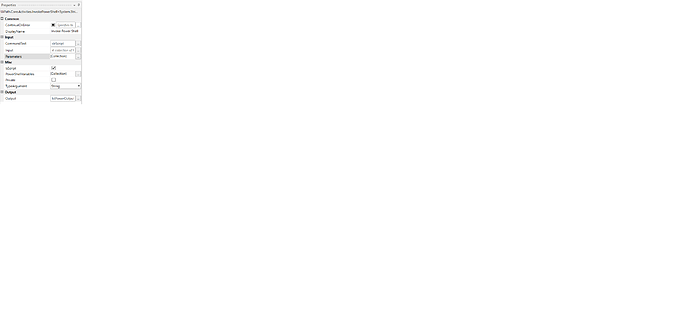

@Lakshmi_Holla Can you maybe show us a Screenshot of the Properties panel of the Invoke Powershell Activity ?
Please find properties panel and also the entire sequence.
