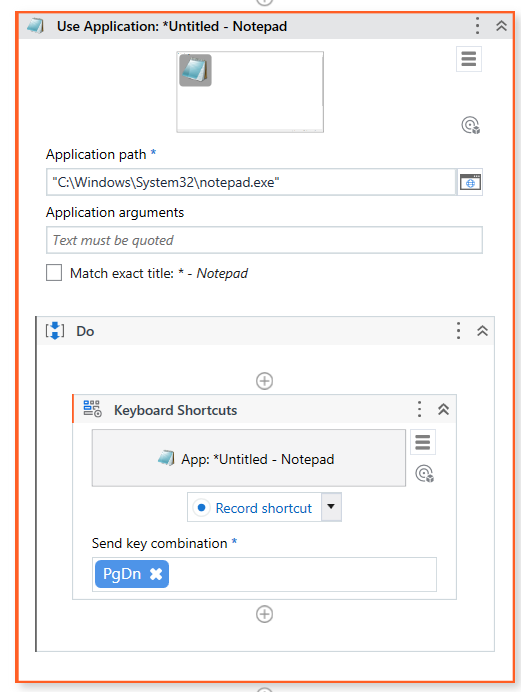

Hi @Lakshmi_Tiliconveli
Have you tried Recording in the Keyboard shortcut Activity
“I am glad that it worked for you. Thank you for letting me know.”
