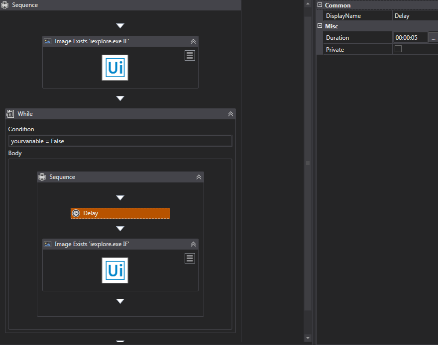

So, just to understand better how the webpage Works. This link Always appear but sometimes with a delay or there is a possibility to not appear at all?
If it is the first option, you could use an image exist, create your boolean variable and create an while like this:
You could try to use the Get Text activity to get the link text then an IF/Flow Decision, I think that both of them could help you in this case, but I’d go for Flow Decision.
The criteria you could use this: yourvariable.Contains(“errors”)
So if the link does not contains “errors” in the text then it’s False, and you’ll go to process 1.
