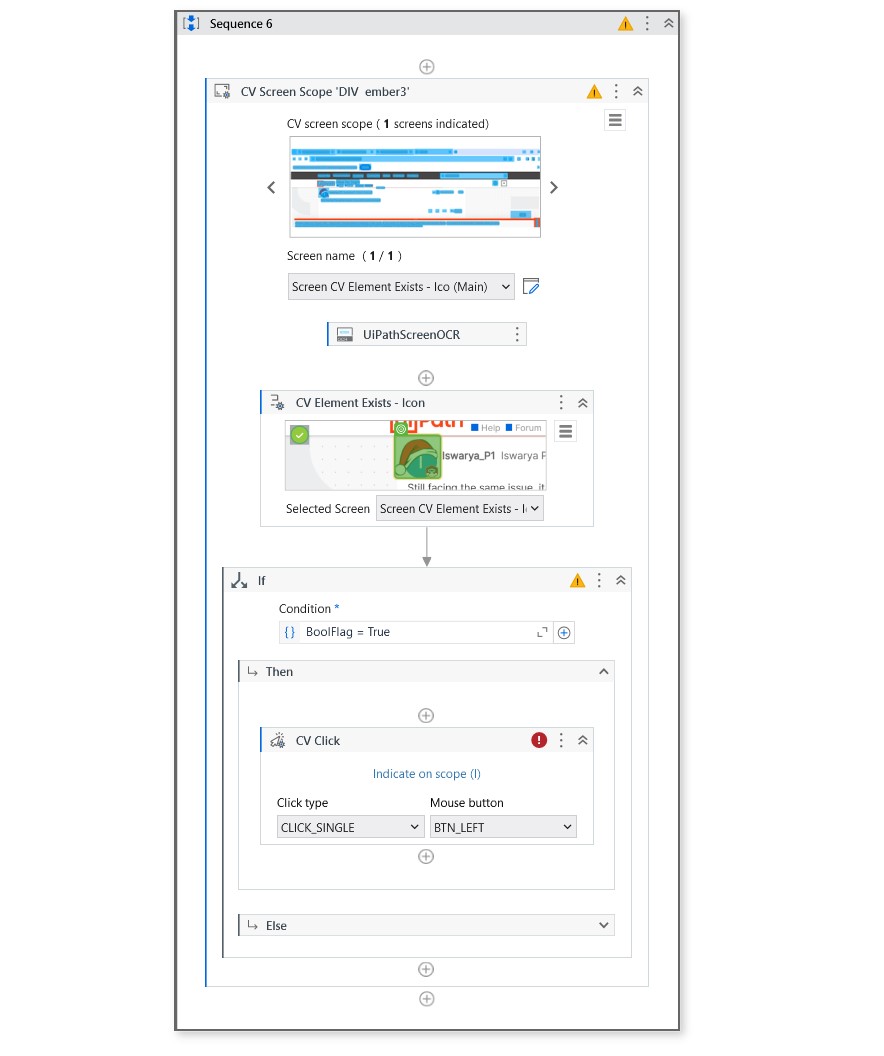

Okay then Instead of using the check app state activity, use the CV Element exist activity. In this activity indicate the Black screen, output of this activity is in Boolean.
After CV Element exist activity, insert the If condition to check the bool flag, In then block give the CV click activity to click on the screen, don’t give any activity in else block.
