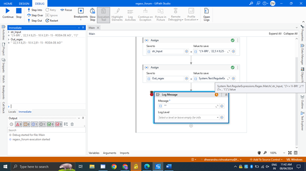

hello @Prasaanth_S2
You can use this regex : (?<=‘X-BRI’ ,).*?(?= , ‘1’)
You can see
regex_Forum
Check if you are getting your result.

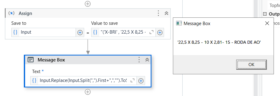

Hi @Prasaanth_S2
You can try the below expression to extract the data between first and last comma,
- Assign -> Input = "('X-BRI' , '22,5 X 8,25 - 10 X 2,81- 15 - RODA DE AO' , '1')"
- Assign -> Output = Input.Replace(Input.Split(",").First+",","").ToString.Replace(","+Input.Split(",").Last,"").ToString.Trim
Check the below workflow for better understanding,
Hope it helps!!
