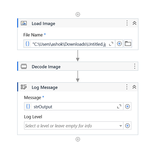

  2. Now install UiPathTeam.Barcode package.
  3. Use activity Decode Image from the package
  4. Here is how to use it. Sample code:
    CICD_Demo.zip (1.5 MB)
Output:
