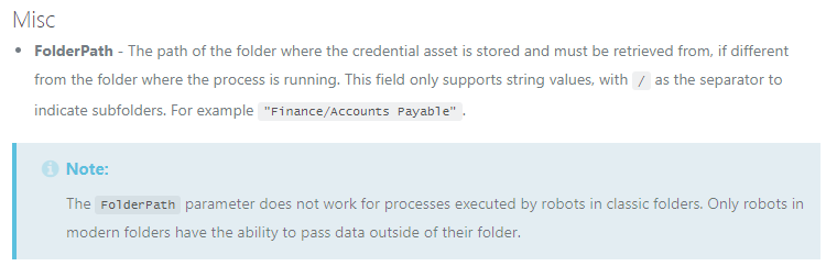

Finally Worked.
Should have left this field empty as I am using Robot.in classic Folder.
