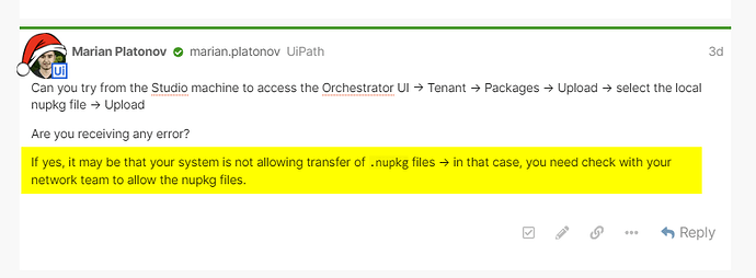

Can you try from the Studio machine to access the Orchestrator UI → Tenant → Packages → Upload → select the local nupkg file → Upload
Are you receiving any error?
If yes, it may be that your system is not allowing transfer of .nupkg files → in that case, you need check with your network team to allow the nupkg files.

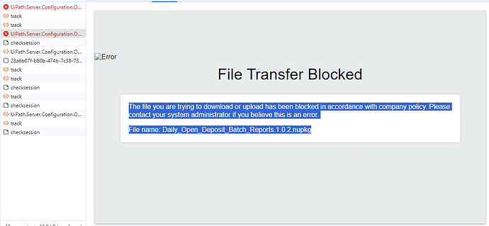

I get this error when I try to upload from Orchestrator.
Then, you need to check more details about the encountered error.
Use the Inspect tool → Network → replicate the error and see the response details.
If you cannot read the details, provide the har log file.
So it looks like it is being blocked by my company. I will reach out to our IT regarding this error.
