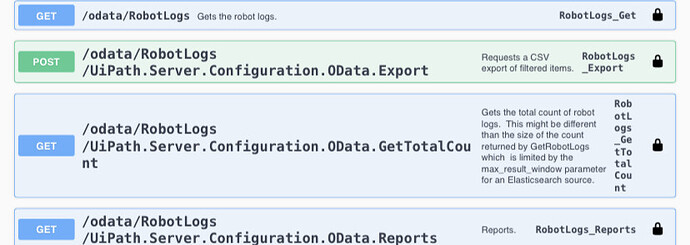

Get the robot logs using these end points
For details check swagger ui
https://docs.uipath.com/orchestrator/automation-cloud/latest/api-guide/api-references
Then from the rsponse get the required data using desirialize json and then add required sata to datatble and then write to csv
