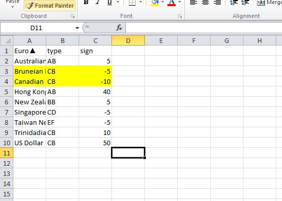

Hello guys .
i want to remove the rows which have type CV with negative number sign (highlighted in the image ) from the DT
kindly suggest .
Hello guys .
kindly suggest .
Use read range and then use for each row and give if condition as row(“type”). To string.contains(“cb”)
Use in then condition as remove data row

Any other way ? the number of rows are high in real case .
Yes use row(“type”).To string and row(“sign”). Tostring.contains(“-”)
Use remove data row activity

Hi @Akhil_Raveendran
You can try the linq query for this
Steps
read the excel and store in dt1
use the assign activity
dt1= dt1.AsEnumerable().Where(Function(row) row(“type”).ToString.Trim<>“CB” And CInt(row(“sign”).ToString>0).CopyToDataTable
dt1 is now a filtered datatable with no type of CB and negative signs
