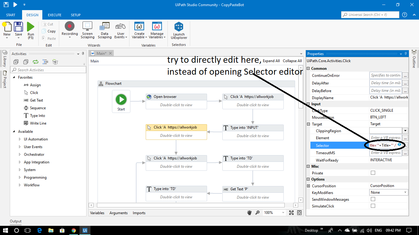

When you click an element and create your selector, it places the selector as an expression for you automatically. You then can edit it by clicking inside the Selector Property of your Click activity (don’t click the edit button). You will notice that the selector is as a string with quotes around it. You can then edit that string to replace parts of it with variables.
For example,
“< title=ABC >”
can be replaced with “< title=”+variable+" >"
Remember, this is in the Selector Property text box; not in the editor.
You can also use the UIExplorer then copy your selectors over, then again, click inside the text box to edit the string.
After you have edited the string to include variables, you will also notice that when you click the edit button it pops up with an expression editor instead of selector editor, so that might help you.
… I probably just confused you but hope this helps, lol.

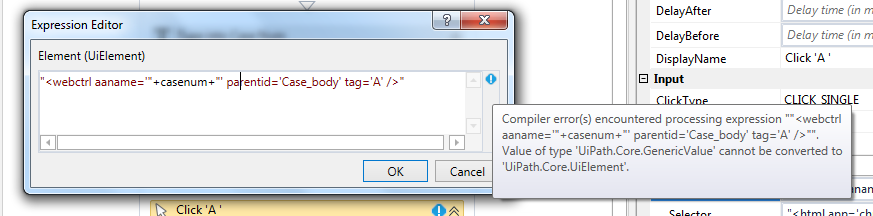

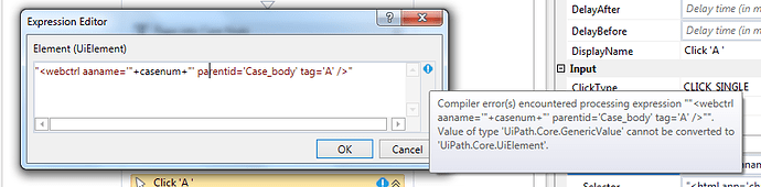

hey how did you solved it? I am trying to pass a variable into the expression editor. I assigned the selector attribuite to a variable with datatype string. Then I tried calling this variable into Element property of Click. But when I call I am getting error that string cannot be converted to Uielement.
This is my Assign
this is the property side of Click activity
Thanx in advance
Hey @amithvs
you are passing that in Element property so it Is showing that error. you have to pass that selector string in selector property.
Regards…!!
Aksh
@aksh1yadav @hkjobs1988 thanx for the quick reply. But click is not working when variable is called within attribuite. There is no validation errors, but getting error like below
cannot find ui element

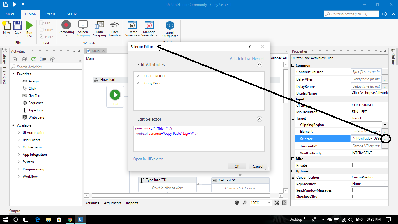

Hi @amithvs ,
when we add a variable in selector using the Selector editor as shown in the picture
will be changed to
So

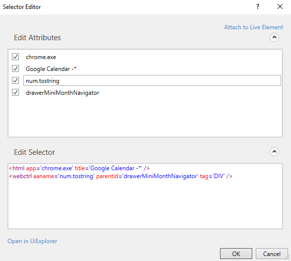

Hi All,
I have similar problem. I have read through all the responses above and am sure I am missing on something.
I am trying to select a date in the google calendar and instead of taking that exact date I am using a variable instead. For now, I am using that variable with a fixed value.
I am not able to use that variable in the selector
Below is the screenshot of my selector
Can someone suggest whats the problem here?
Hi @anshulagarwal,
Copy the below selector and paste in the selector properties
"<html app='Chrome.exe' title='Google Calendar-*' /><webctrl aaname='"+num.ToString()+"' parentid='drawerMiniMonthNavigator' tag='DIV' />"
