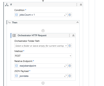

Try Orchestrator http request to specify machine id. They key is Machine SessionIds.
the end part of Process A should look like this. If they end together stagger them using random delay.
