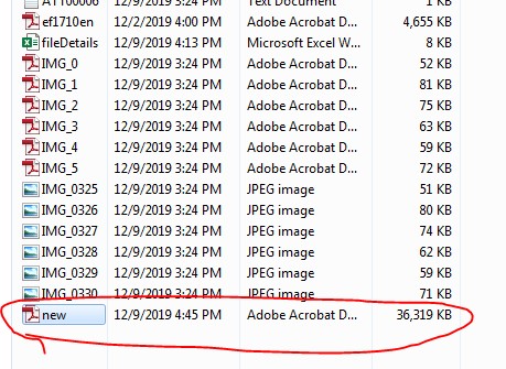

This what i did
But output of this is highlighted in red below “new.pdf”
If I am not wrong here we are not calculating sum of file size. Right?
because file name “ef1710en.pdf” size = 4655kb and
I think we need sum of file size and group them and then merge or join group wise into one file ?
Please correct me and suggest me.

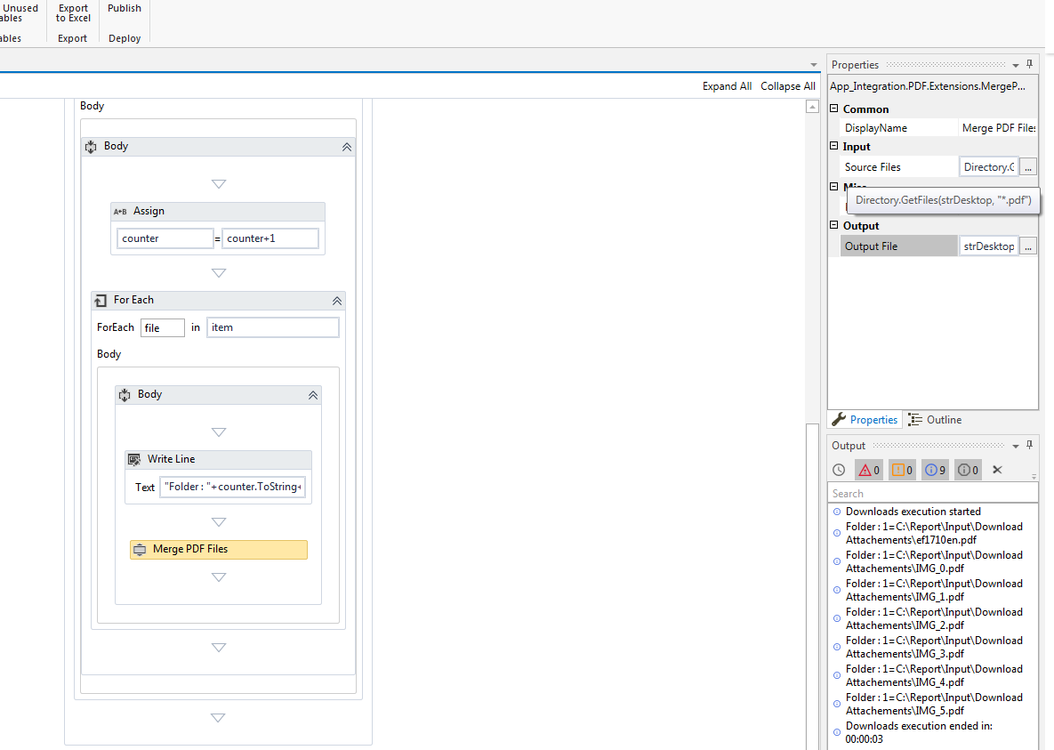

sarathi125
(Parthasarathi)
14
@prashantP,
The files are grouped into List(Of Fileinfo), so you need to pass that to the Merge PDF activity as shown below.
