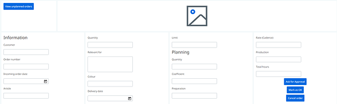

For the moment, I’m only able to display a Excel Chart in UiPath Apps. But when I change a value in the Excel file, the Chart Image is not updated.
So the ultimate goal is, to show an Excel Table in UiPath Apps and when values change in the Excel file, then those changes should be updated / seen in UiPath Apps. I hope somebody can help me.
