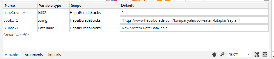

Fortunately the url parameter ends with the page number. The image above is the first page.
I can loop through next pages with pageCounter variable that I created.
However write range activity works only in the first page.
You can get number of last the page and put it into variable, for instance : lastPage
Then, create another integer variable(int start = 1), and use For Each activity to increment that variable until last page. For Each activity would be : for each item in Enumerable.Range(start, lastPage).
Of course, perform actions you need between switching pages.
In order to go to the next page, insert Click activity and indicate on the any page number.
Also, in the selector, which is most important thing - set idx attribute to pageCounter(start from 1)
