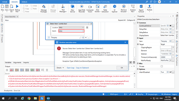

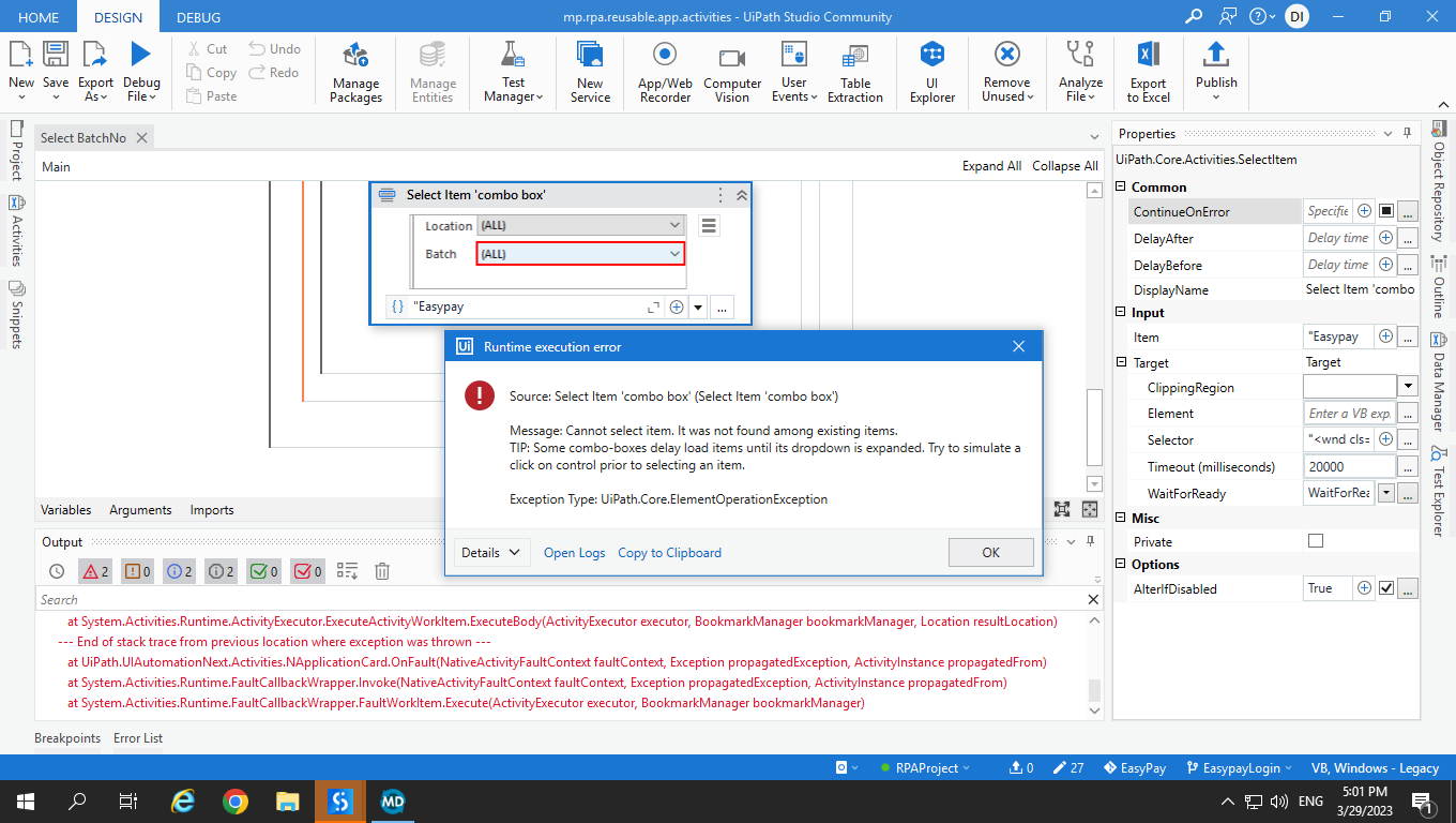

Hi all
I used Select Item activity but its not run in unattended mode i got following error "
Can anyone help me to fix this issue?

Hi @divya.17290
Before using the Select Item, can you try using a click activity to expand the dropdown, and then verify whether you get the same error?
Best Regards.
Same error

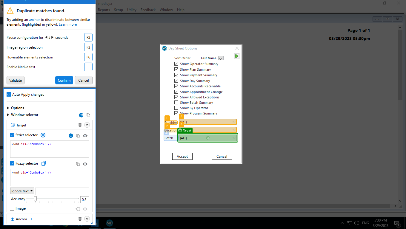

@divya.17290 Hi. As Comboboxes are having same selectors we have to modify the anchor. Choose the Anchor element uniquely. In Anchor, instead of ignore text try setting value as below.
Your selectors look bad…You have to modify them…mostly you would get a sproper strict selector open ui explorer and try doing some analysis on the element you and select the right set of attributes
As of now you have only combobox nothing else
