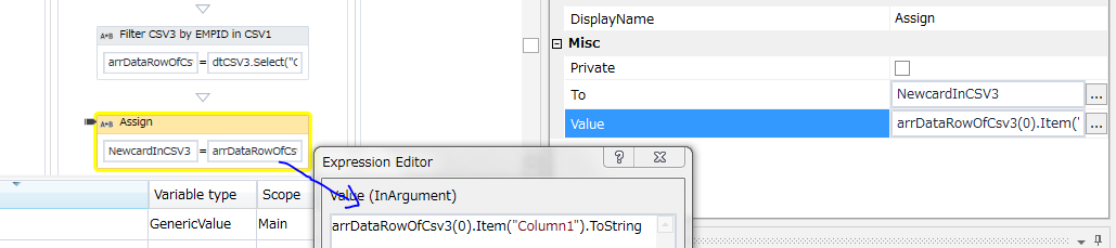

Dear jakelewis18, indra
Thank you very much for your help here…!
I’ve tried assigin data row as attached… I hope this limited screenshot would be sufficient for your advise…
Thank you very much…
Screenshot1
Screenshot2
Screenshot3
uipath20171115-3
@Kn.opp, There might be a chance of returning a empty array of datarow (arrDataRowOfCsv3) after filtering. U are accessing an empty array with some index greater than zero, it returns this error.
Solution : Check the array count before you access it through index !
Dominic :slight_smile:
Dear 599712
Thank you very much, it was the case. I could resolve the select and assign issue.

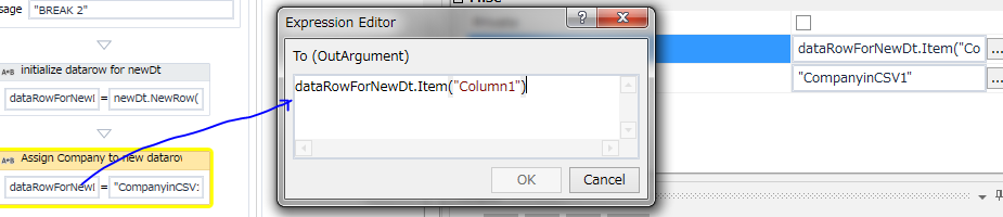

But just wondering if I could ask other question…
When I tried to assng value, I got “Exception has been thrown by the target of an invocation” error as screen shot.
Just wondering how could I resolve this issue?
Screenshot1
uipath20171115-11
Screenshot1
Try :
dataRowForNewDt(“Column1”) = “CompanyinCSV”
