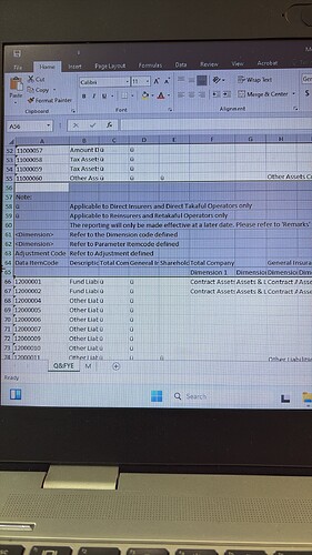

Hi Team,
I have merged 3 sheets into one sheet and after merging I can see duplicates header and some extra rows with words and it is everywhere in between before starting the next set of rows and this is dynamic everytime when I merge this unwanted rows can be in any cell…how do I remove those?
Since i don’t see a pattern to filter and remove,
