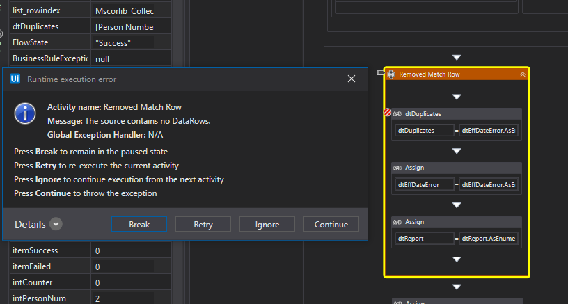

hi @rahulsharma
thank you again for your response,
i dont know how this works, but when i tried i got an Error, Should i put it inside for each row?
or Did I Missed something?
dtDuplicates = dtEffDateError.AsEnumerable().Where(Function(row) dtReport.AsEnumerable().Any(Function(x) x(“Person Number”).ToString=row(“Person Number”).ToString)).CopyToDatatable
dtEffDateError = dtEffDateError.AsEnumerable().Where(Function(row) NOT dtDuplicates.AsEnumerable().Any(Function(x) x(“Person Number”).ToString=row(“Person Number”).ToString)).CopyToDatatable
dtReport = dtReport.AsEnumerable().Where(Function(row) NOT dtDuplicates.AsEnumerable().Any(Function(x) x(“Person Number”).ToString=row(“Person Number”).ToString)).CopyToDatatable
no. no for loop required.
The error states there are no rows in the source.
Make sure the input datatable are not null. Do check that…

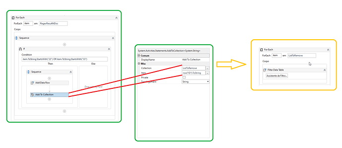

I had a similar issue and I resolved by making a list of IDs and run for each ‘data table’.
I hope that could be helpful.

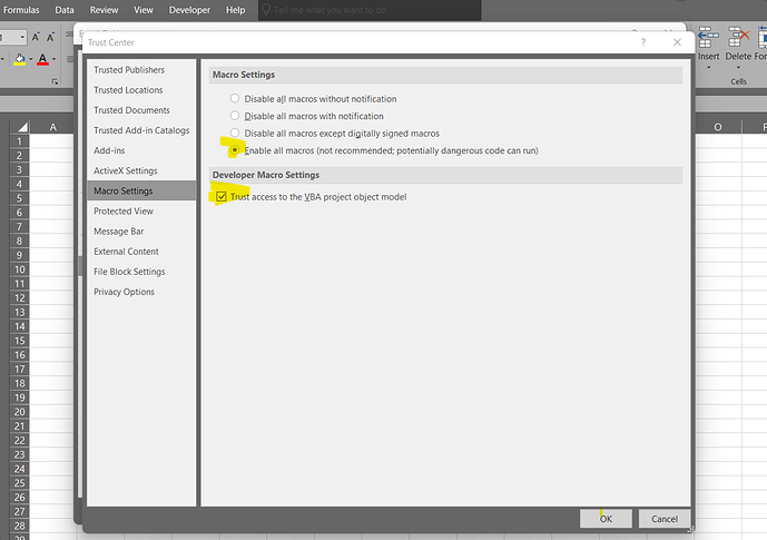

you can use a VB script also to delete it.
Attached the script in the code in new sequence, you can use that.
Make sure you do the necessary changes required for running the macro. You need to update the below setting in Excel Settings
Steps:
File:
FilterForum.zip (23.8 KB)
Hope this should help you resolve your query. If so, mark a post as solution to close the thread
hi @rahulsharma your VB Script is working already, but it writes same data that i need to delete from the table.
