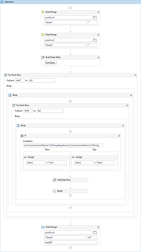

Please find the below screen shot. Try this method and let me know whether it meets your expectation.

I tried the same method as per the screen shot but my result sheet has multiple output.
Please find the below screenshot for reference.

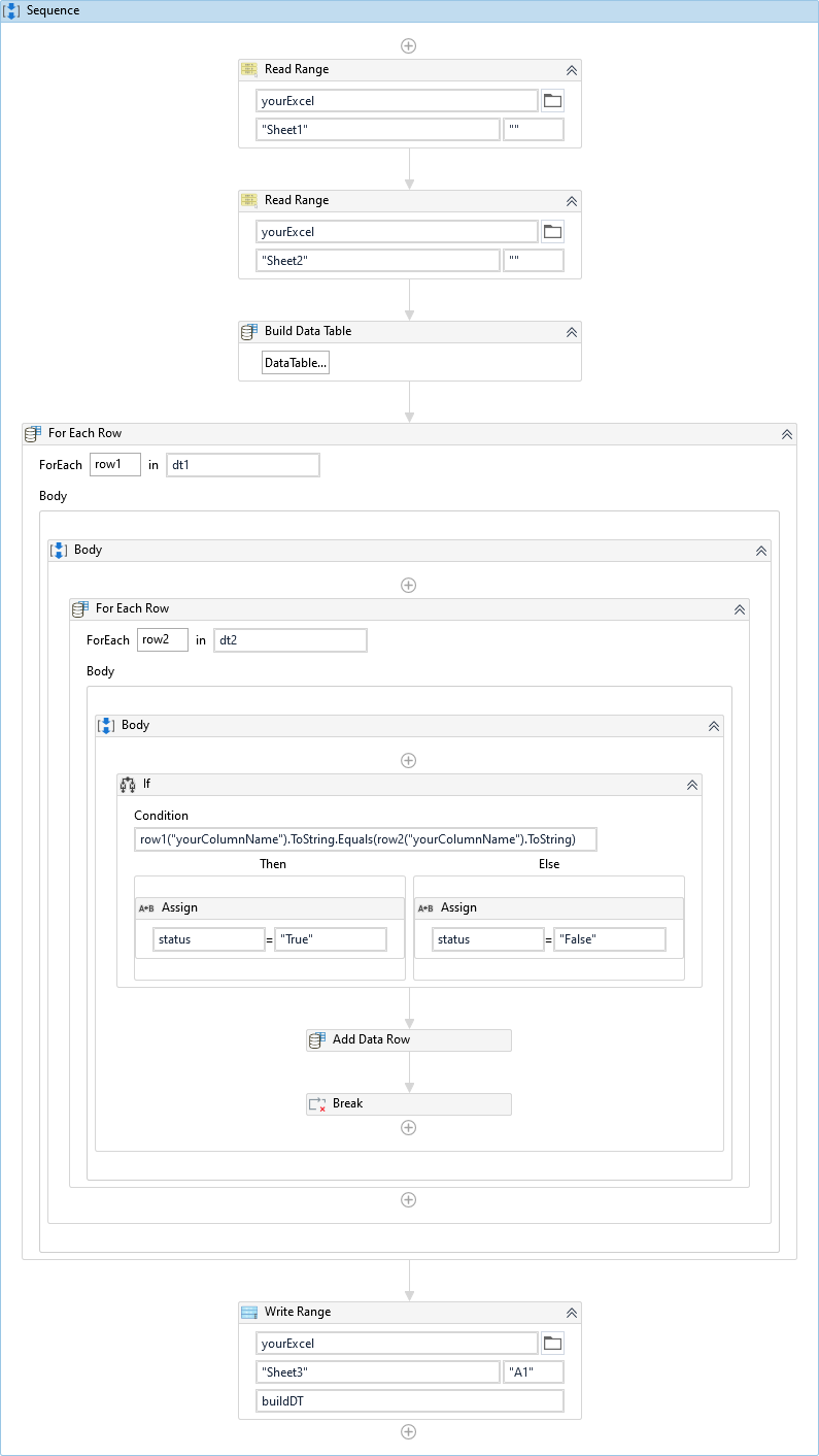

Give break activity and try it. I attached screen shot for your reference.
Thanks
Thanks a lot this is working fine now.

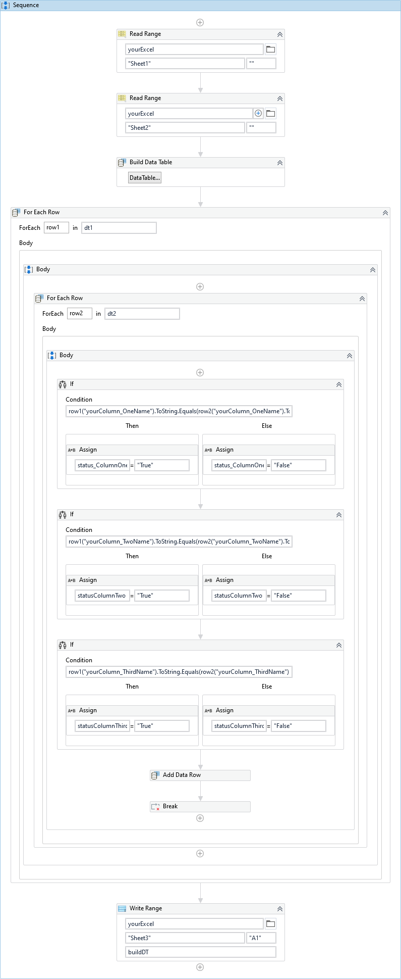

I have column A, column b & column c of sheet1 i need to compare this with column A, column b & column c of sheet2 and print true or false in each cell in new excel
you can build logic like below.
row1(“yourColumnName”).ToString.Equals(row2(“yourColumnName”).ToString) and row1(“yourColumnName”).ToString.Equals(row2(“yourColumnName”).ToString) and
Use And operator in if activity, it will validate all the given columns.

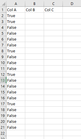

Hi @vignesh.ks
The data is been printed only in Column A where as i need the data to be printed in all columns. Please find the below screen shot as sample output.

Okay, Make build data table has 3 columns, like below:
And then, the workflow should be like this:
Give array row into add data row activity like this:
Thanks.
