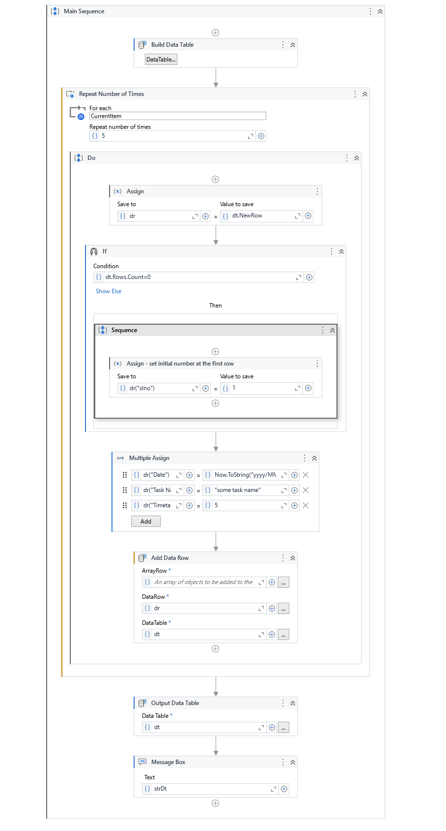

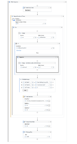

If you want to use AutoInrenment, it’s unnecessary to use counter variable.
Can you check the following sample?
Sample20230501-2aL.zip (3.3 KB)
@Chippy_Kolot
Check here
Main.xaml (10.6 KB)
