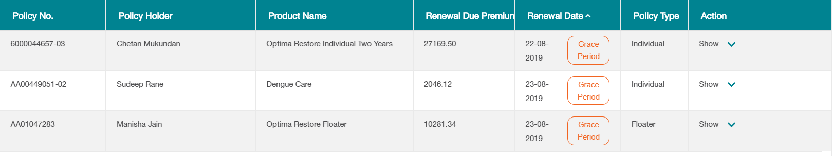

i want to iterate the rows and click each row of particular thing like below image i want to click "show ".

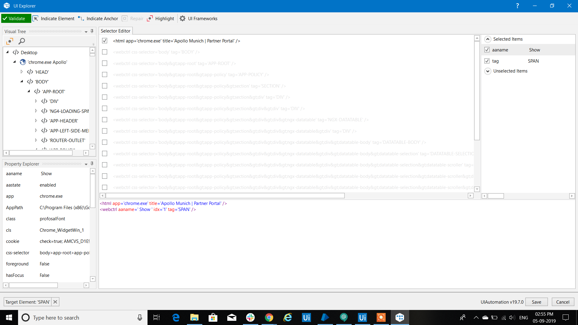

Can you show me the selectors of the multiple elements using UIExplorer.

Can you please share the selectors for the 3 shows in first 3 rows in the table?
Because I think you can use the count as variable in place of index idx = ’ " + count +" ’ and iterate through each row.
@krishnareddy

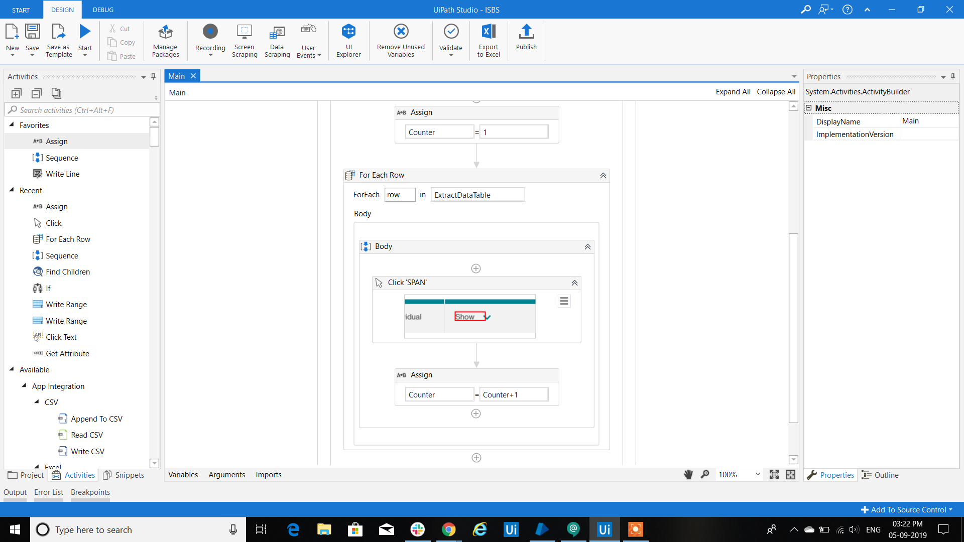

Can you show the selectors of another rows show. if the only Idx is changing then in for each row use Click activity and create a counter with Default value 1 and use this counter in place of 1 of index in the selector of click activity. after that Increase the counter by 1 so it will change the value according to our loop so you have to increase counter as Counter = counter+1.
Just before the click activity. Initialize Count as variable with default value “1” and type “int”.
Then use while activity with condition “count < finalcount” final count should be the max number of rows present on a single webpage.
And after all the things are done. Use assign activity as count = count + 1
Please try. This should work.
And if you don’t have the finalCount or the final count is dynamic Then, you can data scrape the table, which will give you datatable[ExtractedDataTable] variable.
Then use assign activity as given below:
finalCount(Type “Integer”) = ExtractedDataTable.Rows.Count

As I said earlier Use Counter in Index of the Selector and remove the Tag from selectors.
@AryanSingh Where Should i Create finalCount Var
U can use assign then directly use it like this. [Create finalCount before the while just after scraping the Datatable]
finalCount = ExtractDataTable.Rows.Count
Then use condition in the while activity like count <= finalCount
It should work.
