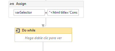

Hello @sam.lee
Take a look at this picture:
“< html title=‘Consulta de saldos e impresión de copia de factura EEGSA – EEGSA’ />< webctrl aaname=‘Imprimir factura’ tableRow='”+ tableRowStr.ToString +“’ tag=‘A’ />'”
After that we have a do while activity
Inside this do while you can find this:
A click activity where you assign, instead of a regular element like the whole html markup above, just the variable name with the incrementing variable already in it. you feel me?
like you construct the varSelector, saying I have this long html and I need to increment it and you have it ready to assign to an activity in this case a click action.
at the end I just add an assign and increment the variable
Happy automation,
Don´t forget to like my other post and if this answer your question, please don’t forget to mark it as solved.
