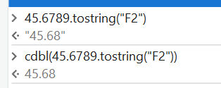

@Soudios - if you are reading that value as string and you want to keep that as is, try that first one…if you are reading as string and use it as double value then use the second…

See my screenshot again.
