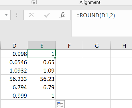

@Yudhisteer_Chintaram1 - Create a new column Say X and using the write cell activity write the below formula…and then use Auto fill range to complete it to the subsequent cells…
Hope this helps…

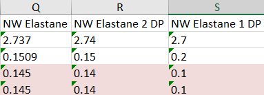

Unfortunately, @prasath17 ,
I noticed an anomaly. I converted it to 2 DP first then 1 DP as shown below:
However, 0.145 should be 0.15 to 2dp then 0.2 to 1 dp.
But it is not the case.
However in another row below I had this value and it got converted well:
What is the issue here>?
In your above screenshot, I found one anomaly too:
It should be 0.45
@Yudhisteer_Chintaram1 - After using “MidpointRounding.AwayFromZero” issue has fixed…
Math.Round(cdbl(row("NW Elasthane")),2,MidpointRounding.AwayFromZero).ToString("N2"))
