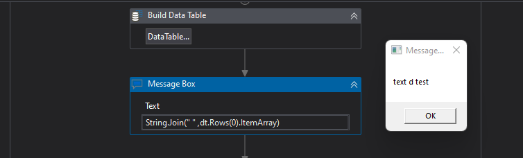

HI @lovepong66
Check this steps
Read range and store in the Dt
String.Join(" ",Dt.Rows(0).ItemArray)
Regards
Sudharsan
You need to change the number as per the row you need @lovepong66
That’s exactly what I want. Thank you very much.
