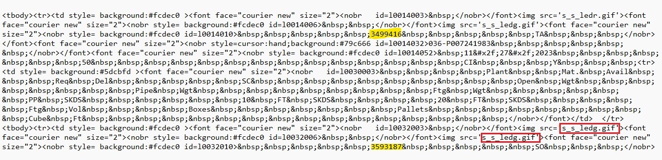

I want to get color checkbox value from SAP, you can refer the below image.
I want to check if its red or green, but I’m not able to find any solution,
I have tried already Get Attribute activity but all attributes are same for BOT color checkbox.

There would be some identifier like some technical code name like s_s_ledr
Look around this.

Both button (red and green) selectors are coming same, not able to find difference, and attributes are also same for both button, do you have any other solution?

After so much effort, I found the solution to getting the color from the buttons, which are images.
This is a Regex expression.
System.Text.RegularExpressions.Regex.Matches(Text, “(?<=3585975.*?src=')(s_s_ledg.gif)|(s_s_ledgr.gif)(?=.*3559722)”).Cast(Of System.Text.RegularExpressions.Match)().Select(Function(m) m.Value).ToArray()
for full info please check this one
