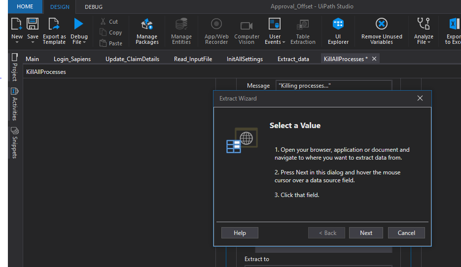

I have enable the Modern design settings and created one blank process. I am extracting the data table from web application using Table extraction of Modern UiPath, once I click on table extraction, I am getting the classic UiPath data scraping popup.
Please suggest your thoughts and reference links.

Hi @rchin ,
Could you also provide us with the Dependencies list that you are using along with their versions ?
Also try to close the Studio and re-open it and check if you’re able to get the Table Extraction Setup properly.
Thanks Superman,
I have updated the dependencies, closed the UiPath and re-opened it
I got the table extraction setup in modern uiapth.
