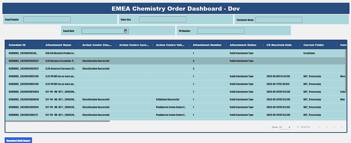

Image 1: This is how data is coming in from Data Service.
Image 2: This data I wish to export in Excel.
So basically all filtered rows I am trying to export.

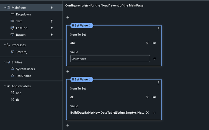

@tilarapiyush
this is how you can do..a sample implementation
initialize a datatable on page load of main, chnage columns as needed
BuildDataTable(New DataTable(String.Empty), New DataColumn() { New DataColumn("Name", GetType(String)), New DataColumn("Email", GetType(String)), New DataColumn("Type", GetType(String)) }, New List(Of Object)().ToList())
use a button click event and then you can save the filtered data to datatable using set value
MainPage.EditGrid.DataSource.data.Select(function(x) dt.LoadDataRow({x.Email,x.Name,x.Type},False)).CopyToDataTable
hope this helps you understand how to send teh fitlered data as datatable directly to process
to show I took the count of datatable..it says 2 as two rows are present
cheers
