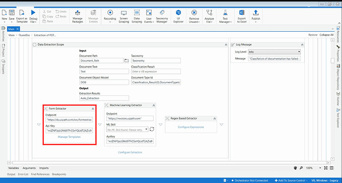

I am using form extractor to extract data from invoice which has 3 lines, it works properly for this invoice. But when I try to execute the new invoice of same format which has more than 3 lines, it does not extract them.
How do I make this execute for dynamic lines of same format?
Kindly help me out

@Gokul001,yes I am using document understanding with form extractor.
But the issue is when a vendor uploads invoice with multiple lines as I have attached the invoice above.
Read pdf text will get us text of the particular invoice, after that we need to add regex for extraction.
I have multiple vendors with multiple lines and I am using form extractor, I need to extract data with dynamic line items.
