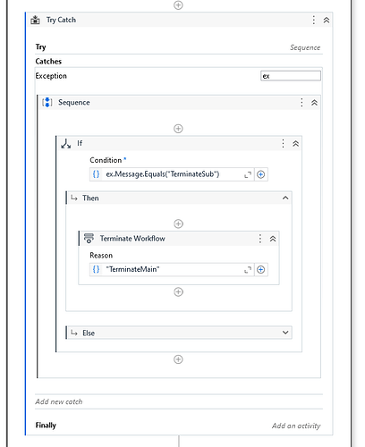

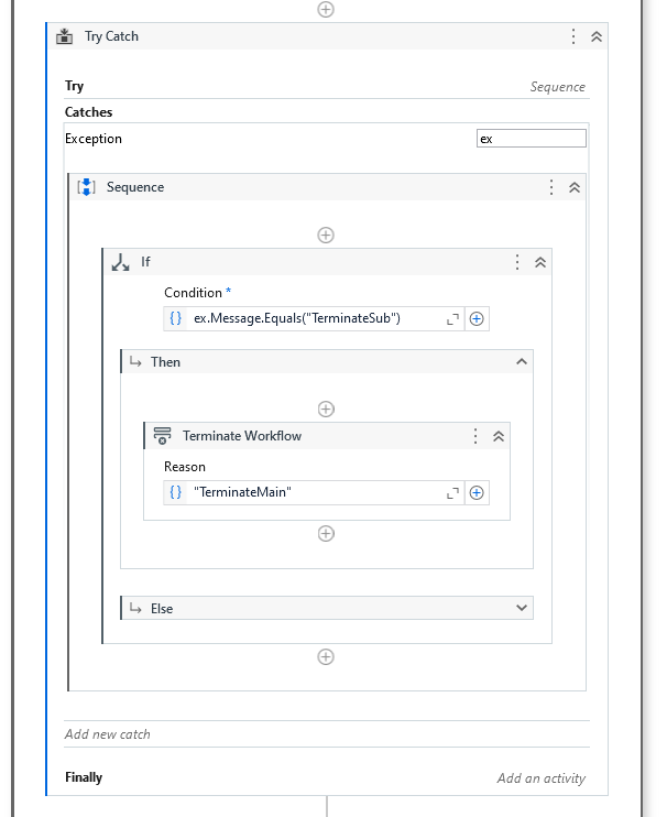

Terminate Workflow will only terminate the workflow it resides in, not the process. If you call Terminate Workflow in a sub workflow, only that workflow will be terminated. If you want to end the process, you need to call Terminate Workflow in the main workflow also (in the catch section).
In sub workflow:
In main workflow:
