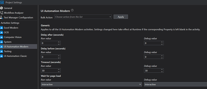

Meanwhile i found a non elegant solution…
I could follow the above link but the delay was the problem
I had to change the default delay to make it work from project settings
