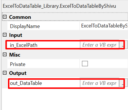

Sure… we have our Test data present in the Excel Sheets… as like every Test framework we planned to have a Common function library which can used to return data and perform any functional operations etc… So we are able to Create one Sequence in function Library which reads the excel and gives the Data table…but when comes back from library to process type… we able to publish the library and able to call that activity but how can we get the activity returned data table and using that data table in Test case or datatable values passing as a Test data to methods.
When you add this package you can find below shown activity, Please specify your excel path in in_ExcelPath , and you can create a data table variable and map it to out_DataTable. This will return the data table.
Yes, this one will solve my issue… but how can you return the Output as Data table… please let me know also so that i can implement in my other functions…
