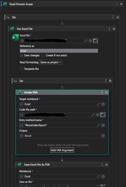

After trying MANY different approaches, I’ve found that the most reliable and clean method is using a VBA macro with Invoke VBA, combined with UiPath’s Save as PDF activity.
Step 1 - Create a Excel Process Scope.
Step 2 - Create a “Use excel file” activity targeting your excel file.
Step 3 - Create a Invoke VBA activity" targeting your excel file. Create a .txt file with the following script:
Sub ResizeSalesReport()
    With ActiveSheet.PageSetup
        .Zoom = False
        .FitToPagesWide = 1
        .FitToPagesTall = 1
        .Orientation = xlPortrait  ' or xlLandscape
    End With
End Sub
Step 4 - Set the parameter “Code file Path” to the script file and the “Entry method name” parameter to “ResizeSalesReport”.
Step 5 - Create a Save Excel File as PDF activity
Example Image:
