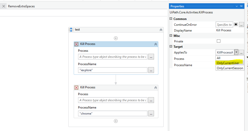

Hi @MJ_LEE ,
You can use as shown below and don’t forget to select only current user if you have multiple use machine for same server.
You can use either chrome or IE.
My be there is a difference in version, leave it for now.
