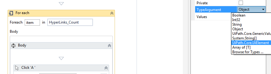

I am not able to get what’s there in reference link as i have only 3 months exp in uipath. I am using Find chidren activity and finding out all hyperlinks as elements and i want to click on those i have used for each but while giving target as element not the selector it is showing validation error could you please help me out in this.

You just need to change the type argument from object to UiElement in the for each loop , as the Find children returns IEnumerable<UiElement>
And pass the item in the element property of click activity(not the selector).
Check now.
