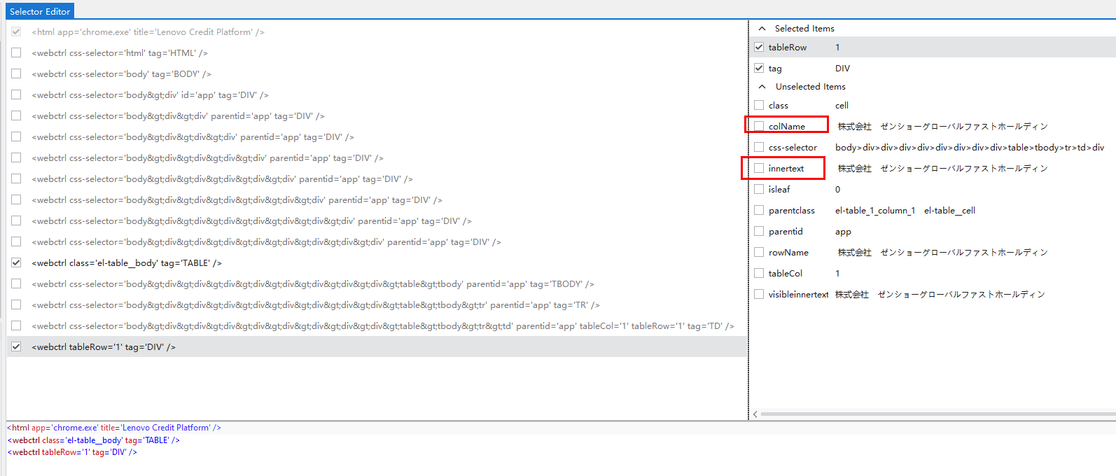

Seems there is no big difference in selector when I only click this long text customer name :smiling_face_with_tear:
Please check how aaname attribute is extracting the data for the long text. @yangyq10
Regards
@vrdabberu And its weird that there is no aaname in long text name. Should I put more name in strict selector?
Long Name
Short name
Okay then for long name the aaname attribute is not visible so change the attribute to inner text and follow the same steps as done earlier and please update me the output. @yangyq10

@vrdabberu
Hi I am back. It still doesn’t work
Its so weird, I try record but still can’t click the hyperlink :smiling_face_with_tear:
Hi @yangyq10
Please share the screenshot of the modified selector’s so that it will help to find the issue.

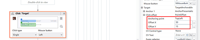

@vrdabberu
I test many times in last one hour and fix it by below solution :laughing:
Pls take a look if it makes sense
Actually the process done by you will work for few cases only. If the window position is changed or else the window size gets changed then the solution done by you will get failed. @yangyq10

@vrdabberu
OK, this is the screenshot of selector
