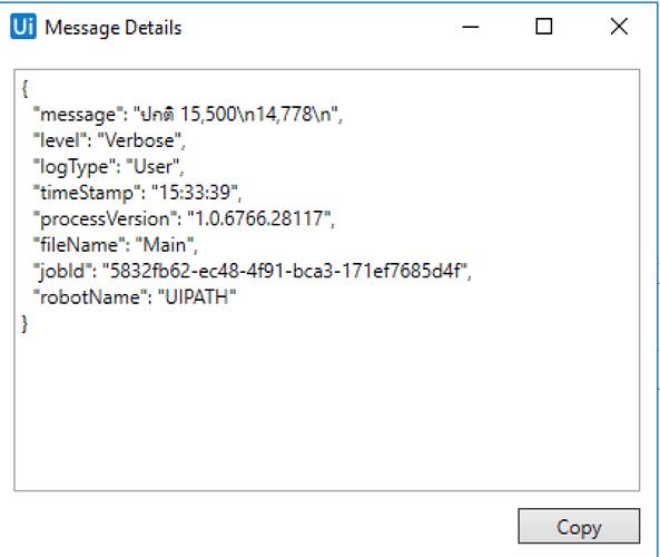

i have issue. I extract data from some website. then we have data table right.
but deta in data table is like
and in write line show
I need to remove “\n” because i need value inside \n$$$$\n.
I try use indexof find “\n” it not found.
I try use replace(“\n”) it not found.
I try use “\r\n”,environment.newline
please help me i try to search and try to do.

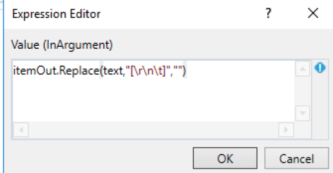

Hi, I am also new in uipath. You can try with String.Replace(text, “[\r\n\t]”, “”) to remove \n.
indra
(Indra)
6
@Saroch_Kamjikong Can you share what error you are getting
Hi @Saroch_Kamjikong, use:
itemOut.Replace(Environment.NewLine,"")

@Saroch_Kamjikong Change your variable x now its in type generic to string type
@Saroch_Kamjikong, change:
x = itemOut.ToString.Replace(Environment.NewLine,"")
And change x to String.
@indra @Bernardo_Ferreira
it still. what i’m wrong?
Please paste here what the robot is print in the Console, please.
That way I can test it.
PS: I don’t have access to the Silk website.
@Saroch_Kamjikong, go with:
x = System.Text.RegularExpressions.Regex.Replace(itemOut,"[\n]","")
Awesome!!!
pls explain why can’t use itemOut.Replace()
and than you every one.
