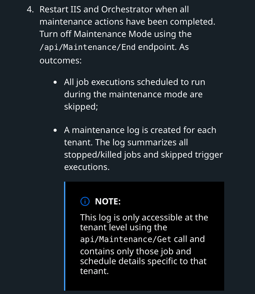

@jketchas
Looks at this endpoint…this might give you the time stamp…which can be leveraged
That is for putting Orchesrtator in maintenance mode: Orchestrator - Maintenance Mode
Thanks though :slight_smile:

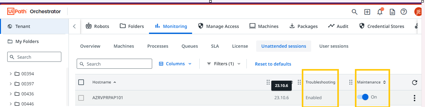

I’m looking for something to monitor machines pulled out of production from Tenant → Monitor → Unattended Sessions. Below you see one machine has troubleshooting Enabled and is in Maintenance Mode. I’m looking for a way to check this without using the frontend.

Try using the get host admin logs…in logs you would have the machine suspended details…get the time from it…that can be used for your condition
First and last are to put and remove from maintenance mode…that is a different one
You can check when is the last trigger skipped or last job stopped for a machien and then find how much time the maintenance mode is present
You dont have any direct api for all details…this is more like a combination that you can use

Hello,
Based on my testing, when creating a new process that targets a machine with Maintenance mode enabled and/or Troubleshooting enabled the new job will go into pending until both Maintenance and Troubleshooting are disabled.
To help clarify, here is a pic of where in Orchestrator I am referring to:
I am looking for a way to detect whether these switches are enabled (along with the timestamp of last state change if possible). And I am looking to do it outside of any UiPath Studio workflow. This is so we can build an inhouse tool to watch machine states. The purpose for the support ticket is to gain knowledge of how to poll the machine state (for Maintenance & Troubleshooting) either through the API (which I don’t think you can), or through some SQL query in the database.
I first looked through the Swagger API thinking something from the Machines endpoint would have this information, but I did not see anything I am looking for. I don’t think the API provides the information I am looking for, but leave that for you to confirm.
I then took a cursory look at the Orchestrator DB but again did not find anything referencing these machine state for Troubleshooting and Maintenance. I am assuming that these details are in the Orchestrator DB and hopeful that a SQL querying this information could be shared with me.
