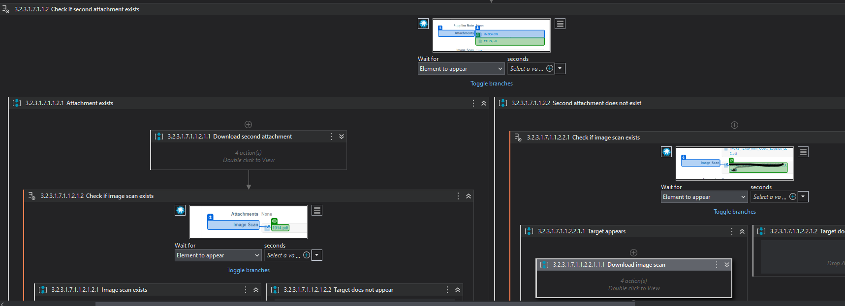

I am having issues with my code. My bot needs to go to this website and check if there are attachments and image scan. If yes, than we download, if no, we print the whole page.
First I am checking if the first attachment exists
If there is a first attachment, I am using an if condition of: If the name of the first attachment is not equal to the name of the image scan, and the name of the second attachment is not equal to the name of the image scan, download the first attachment. (This seems to not me working either, since it is downloading everything even if it has the same name)
Then I check if there is a second attachment (I think my problem is in here somehow)
If the second attachment exists, download it and then check if image scan exists and if exists, download it, if second attachment does not exist, check if the image scan exists
The problem I think I am facing is that the bot is downloading the first attachment that has a different name from the image scan, and there is no second attachment. I think it keeps looking for the second attachment.
