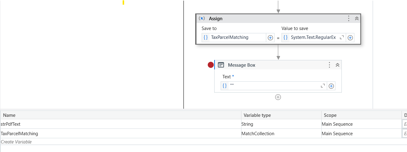

Use regex (?<=Tax Parcel: )(.*)
Utilize the code as mentions below in UiPath inside Assign activity.
Result is of type MatchCollection
System.Text.RegularExpressions.Regex.Matches(strPdfText, "(?<=Tax Parcel: )(.*)")
How do I convert the output to a string? I tried output.Value(some index) and output.Value but the editor throws an error for both.
Appreciate the help!
Hi @greff
Regex Pattern: (?<=Tax Parcel\:\s+).*
=> Read PDF Text activity
Output-> inputString
=> Use Find Matching Patterns activity and configure like below:
Pattern: "(?<=Tax Parcel\:\s+).*"
Text to search in: Your pdf text output variable
Result: Create a Variable say Matches
=> Use For Each loop to iterate through Matches variable and CurrentMatch.ToString
will print the extracted value.
Regards

Hi @greff
Check the below zip file
NewBlankTask.zip (253.8 KB)
Output:
Let me know if you have any queries.
Regards
Hi @vrdabberu, I ran your xaml and I am weirdly not seeing any output again. I am using StudioX by the way.
Hi @vrdabberu,
Here you go
1st_set.pdf (74.2 KB)
Hi @greff
Check out the zip file. Let me know if you have any more issues.
NewBlankTask.zip (323.2 KB)
Output:
Regards
Hi @vrdabberu, thank you so much! that regex expression seemed to work. Any idea why it is only getting 17/22 parcels though?
Hi @greff
Do you want to get all 22 parcels then try the below regular expression:
(?<=Tax Parcel: )(.*)(?=\nReal Debt|\n\d+\/\d+\/\d+)
Regards
