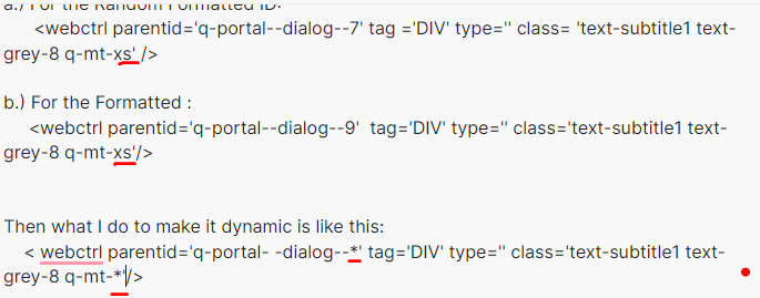

I am using the Fuzzy Selector, for more information. Here’s the SAMPLE values inside the Fuzzy Selector:
a.) For the Random Formatted ID:
< webctrl parentid=‘q-portal- -dialog–7’ tag =‘DIV’ type=‘’ class= ‘text-subtitle1 text-grey-8 q-mt-xs’ />
b.) For the Formatted :
Then what I do to make it dynamic is like this:
< webctrl parentid=‘q-portal- -dialog–’ tag=‘DIV’ type=‘’ class='text-subtitle1 text-grey-8 q-mt-’ />
Thanks in advance for helping me!

Hi Sir Steven! Thank you
I am using the Fuzzy Selector, for more information. Here’s the sample values inside the Fuzzy Selector:
Then I change it into this, because I believe this should make it dynamic:
Give this a try:
< webctrl parentid=‘q-portal*dialog*’ tag =‘DIV’ type=‘’ class= ‘text-subtitle1 text-grey-8*’ />

Try to open selector in ui explorer and select the attributes which are not changing as mentioned
Thank you so much Sir @Steven_McKeering , I tried it twice and it worked. I’ll test it on other scenarios also.
